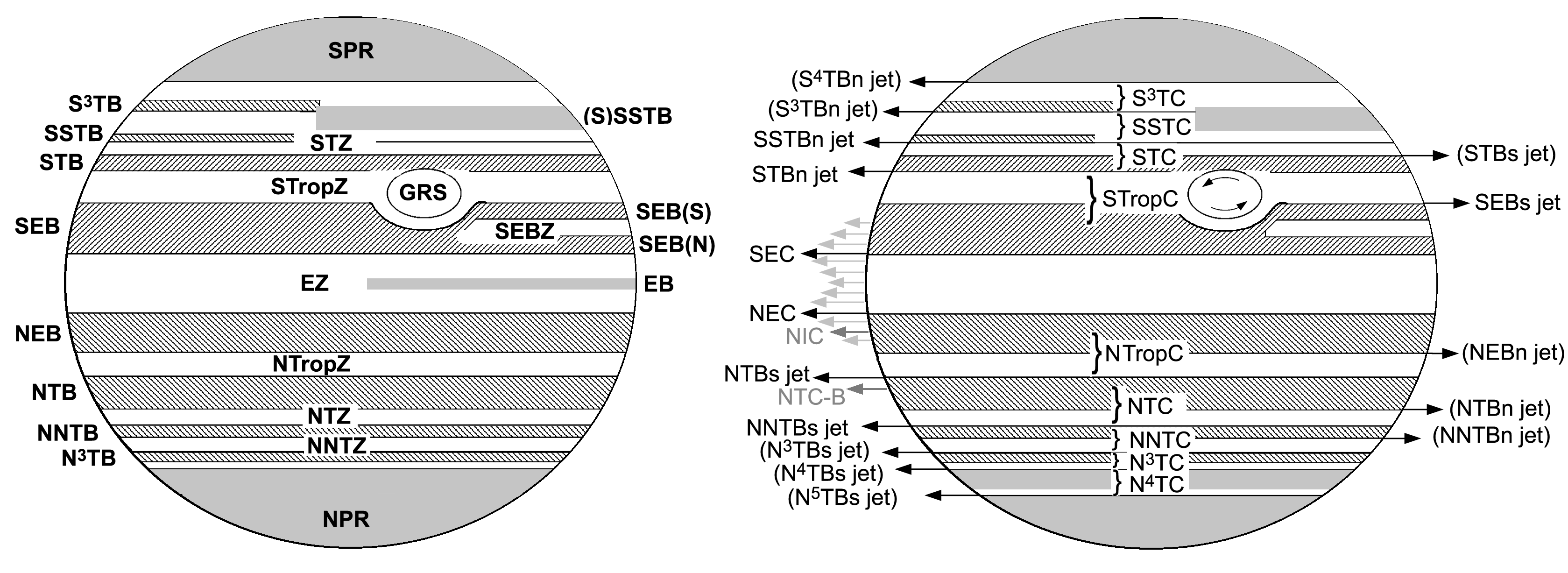

Se denne fra Clyde Foster
Lidt hjælp, hvis man er forvirret over de mange forkortelser:
Lidt om SEB:
South Equatorial Belt (SEB.)
This is one of the two primary belts on Jupiter, and is also probably the most active belt on the entire Planet. It is also seen of periodic disturbances, including the spectacular SEB revival.
Fra Wiki:
The South Tropical Region includes the South Equatorial Belt (SEB) and the South Tropical Zone. It is by far the most active region the planet, as it is home to its strongest retrograde jet stream. The SEB is usually the broadest, darkest belt on Jupiter; it is sometimes split by a zone (the SEBZ), and can fade entirely every 3 to 15 years before reappearing in what is known as an SEB Revival cycle. A period of weeks or months following the belt's disappearance, a white spot forms and erupts dark brownish material which is stretched into a new belt by Jupiter's winds. The belt most recently disappeared in May 2010.[42] Another characteristic of the SEB is a long train of cyclonic disturbances following the Great Red Spot. Like the NTropZ, the STropZ is one of the most prominent zones on the planet; not only does it contain the GRS, but it is occasionally rent by a South Tropical Disturbance (STropD), a division of the zone that can be very long-lived; the most famous one lasted from 1901 to 1939.[43]
